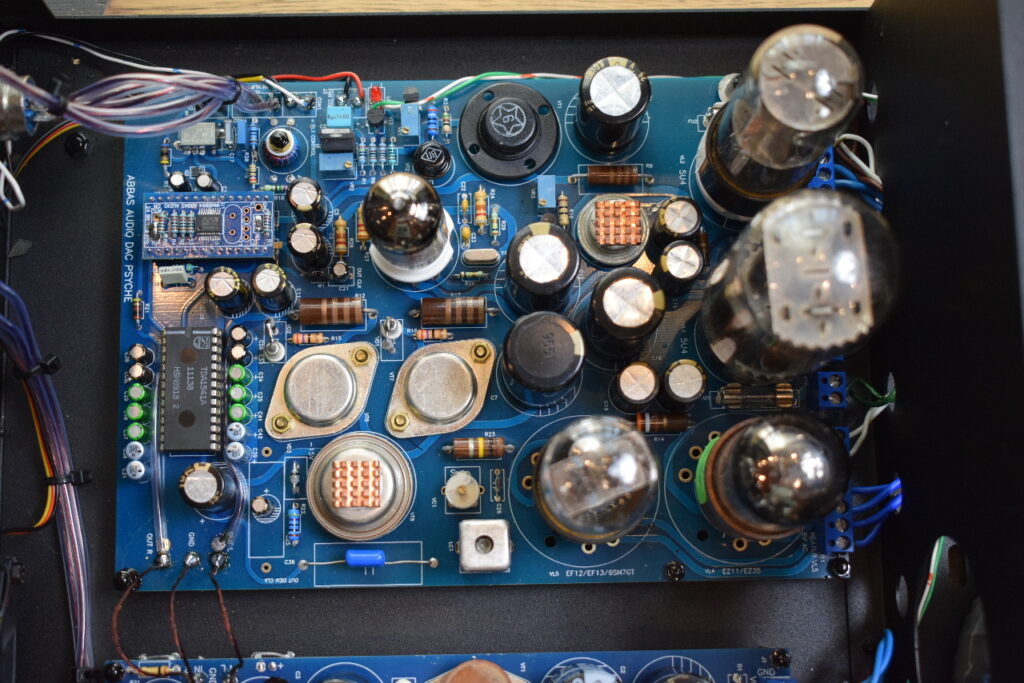

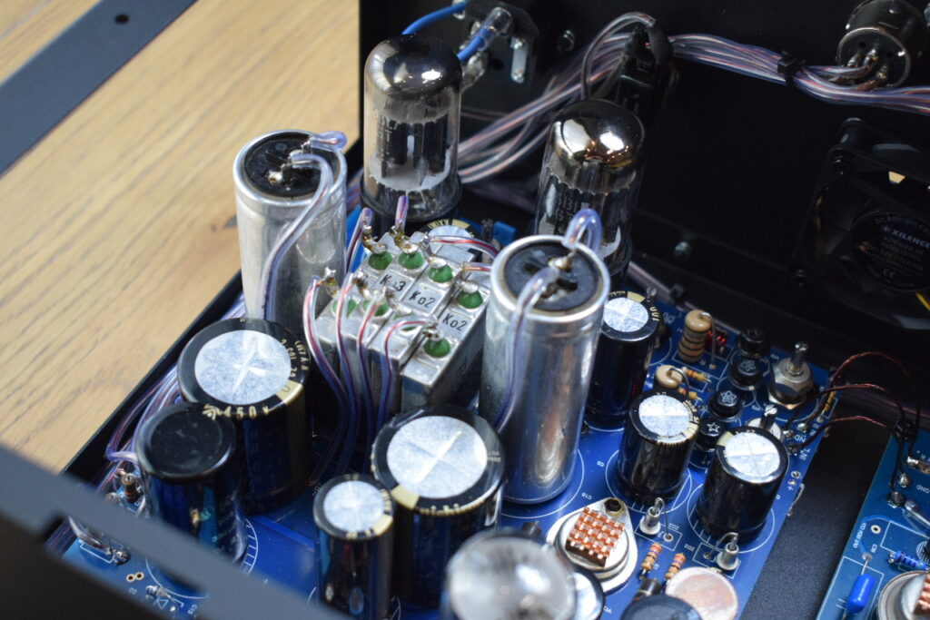

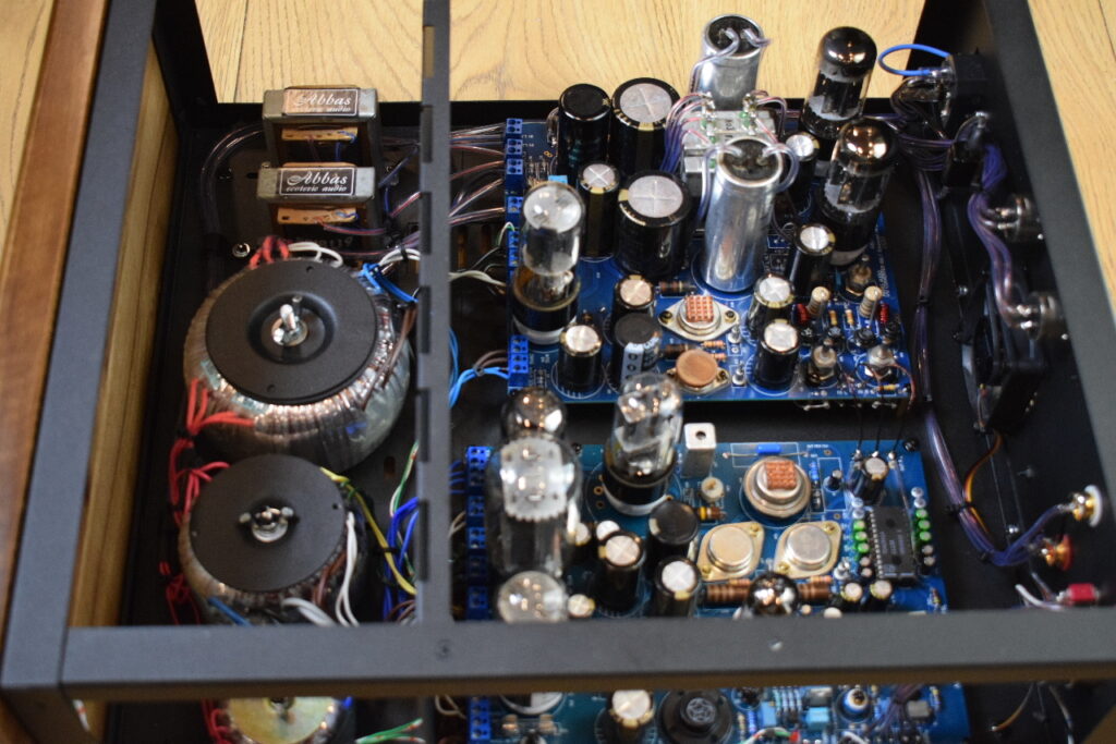

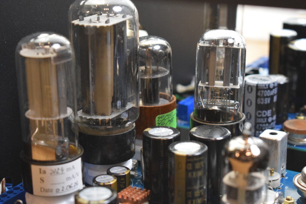

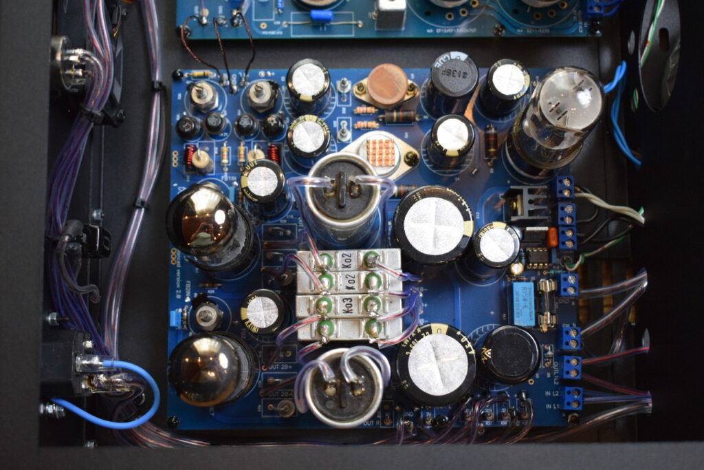

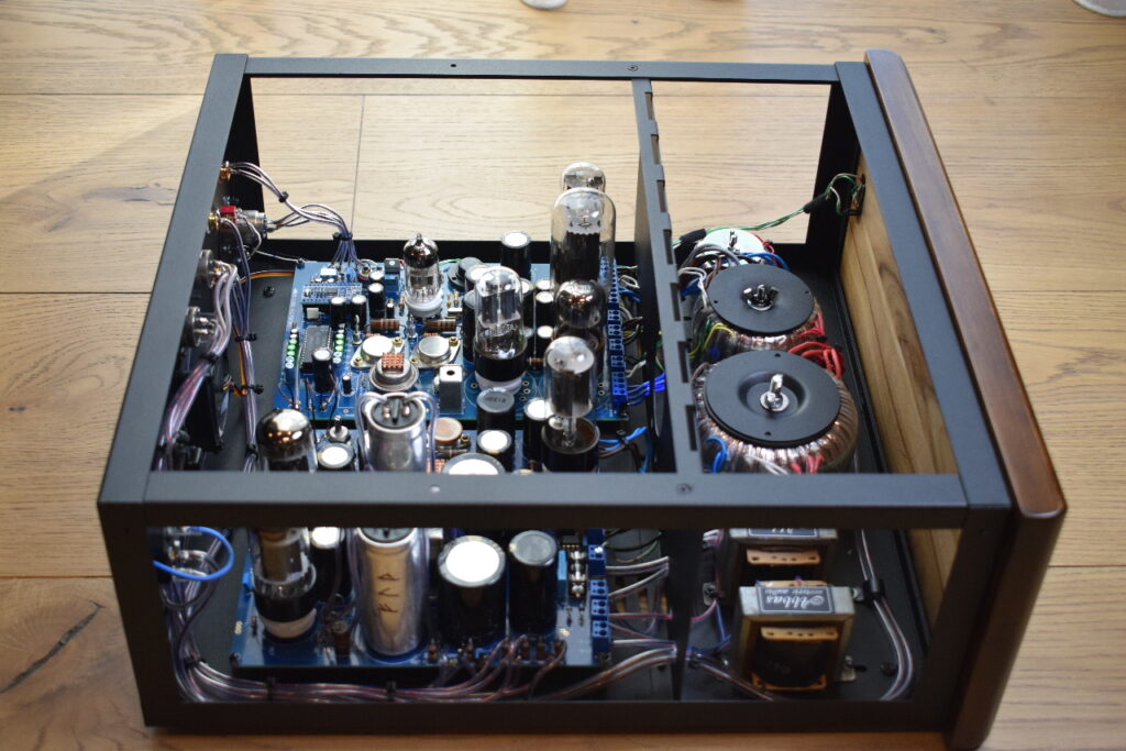

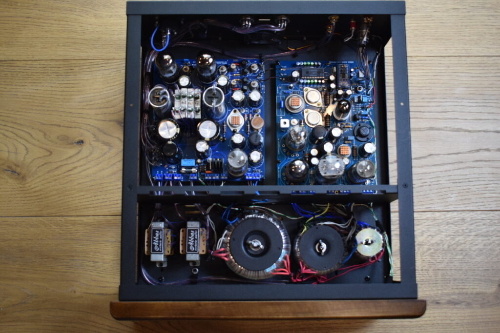

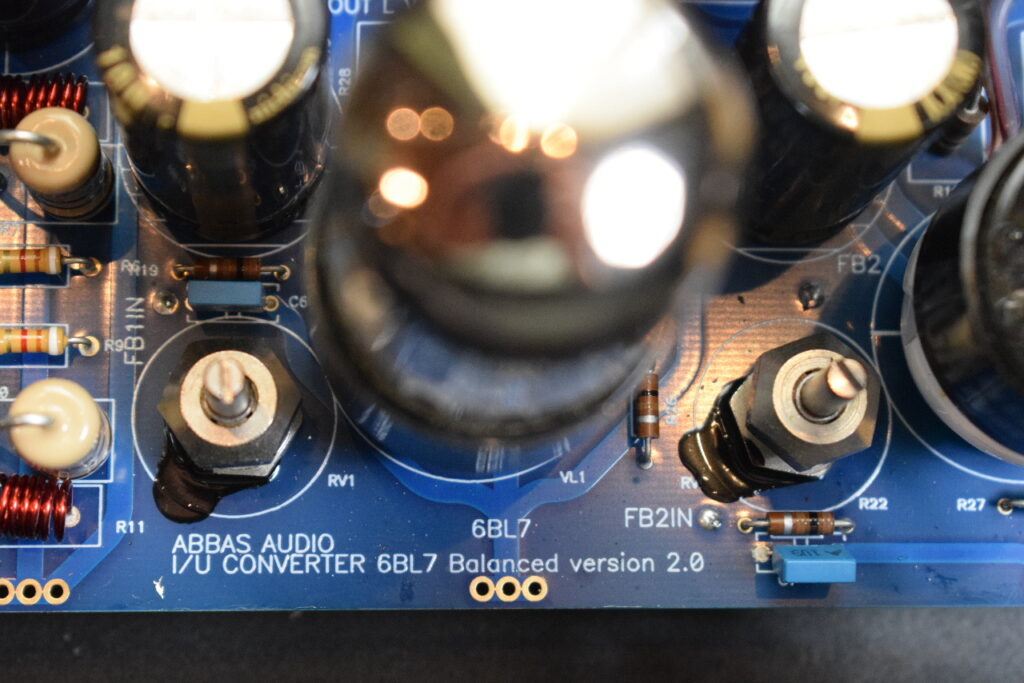

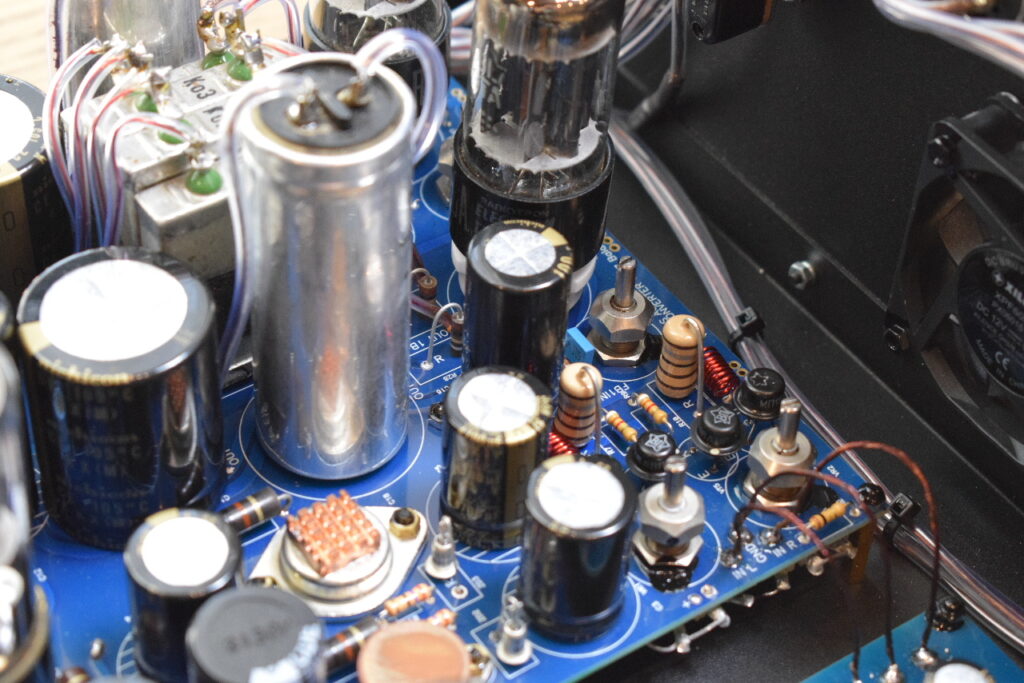

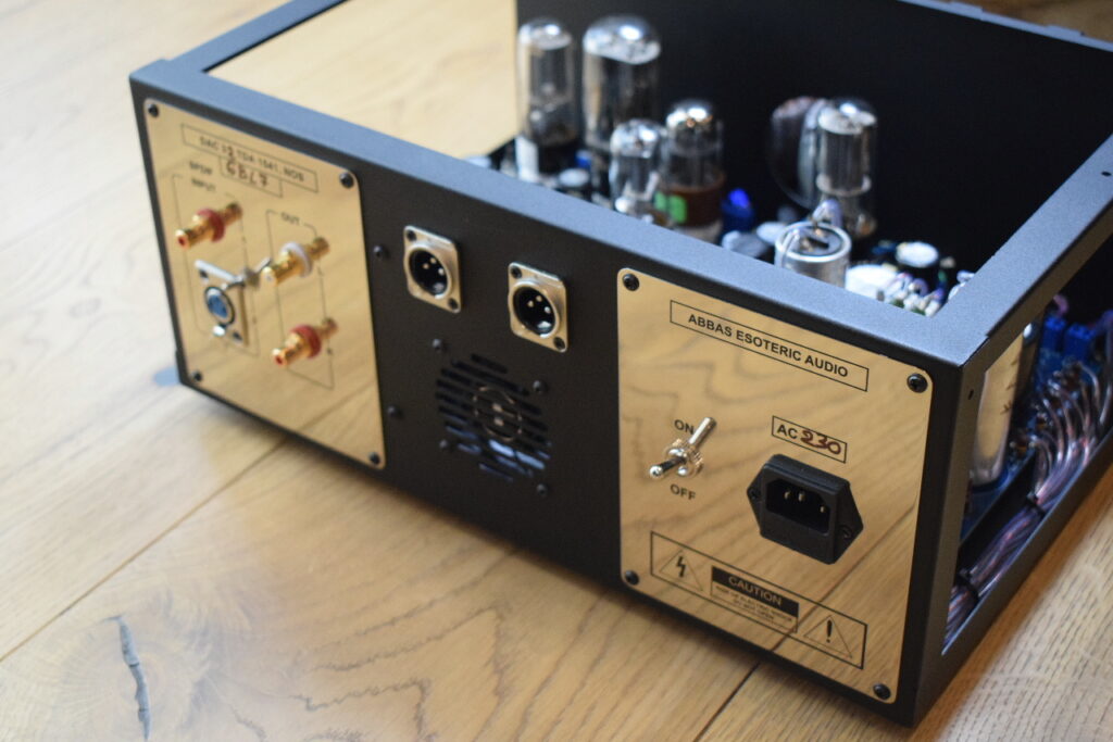

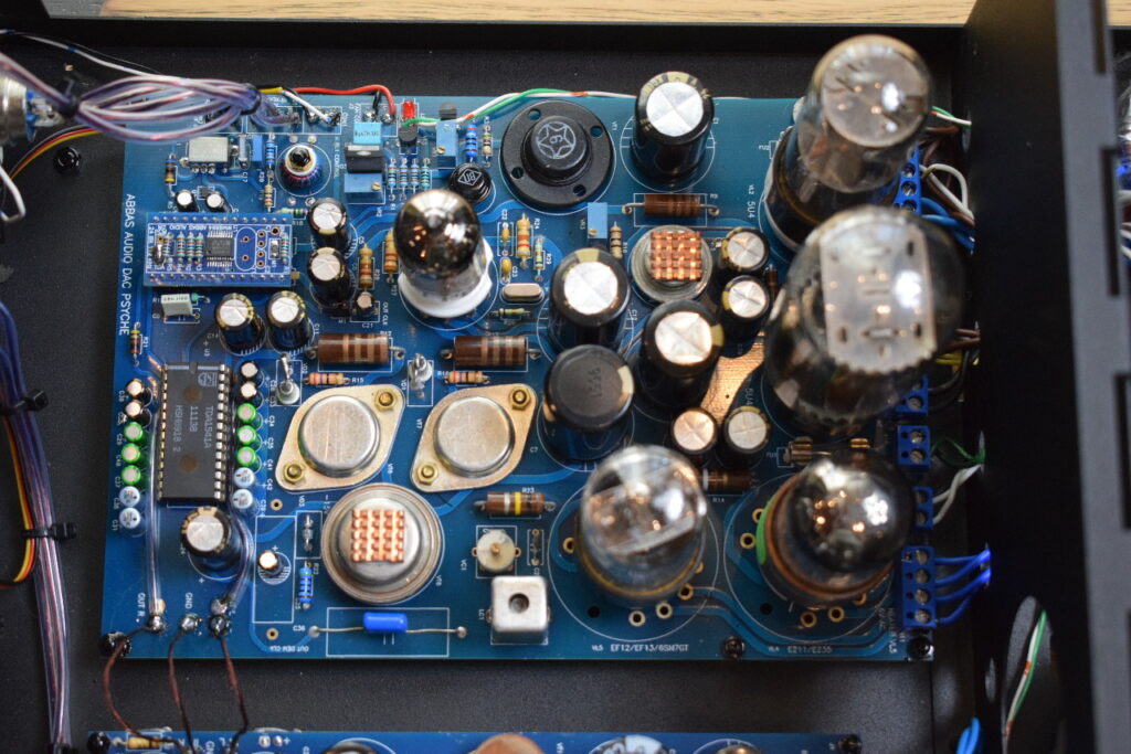

The balanced version of the Psyche features a 6BL7 output stage. The digital section is identical to that of the version with the 6080 output stage. See the previous article.
One half of the 6BL7 tube is an output stage with an unbalanced RCA output, 4v RMS/0dB level.
The other half is a phase-splitter stage with an XLR output, 2v RMS/0dB level.
Both outputs operate simultaneously. Unlike the 6080 stage, this version features per-channel output level control. If you’re using output tubes that aren’t perfectly matched, you can equalize the channel output.
