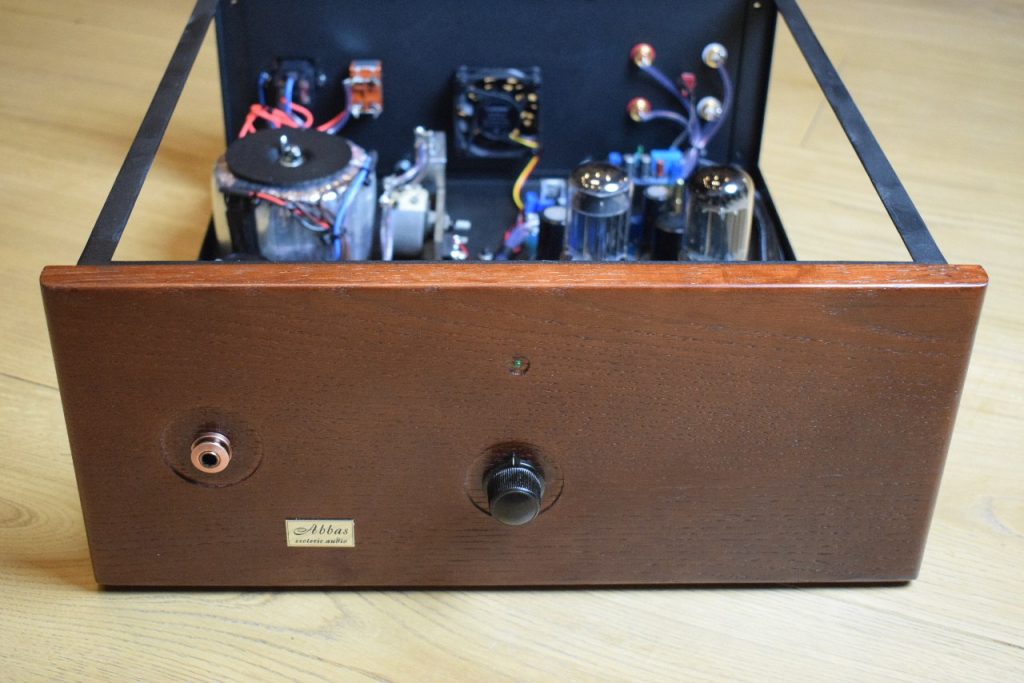

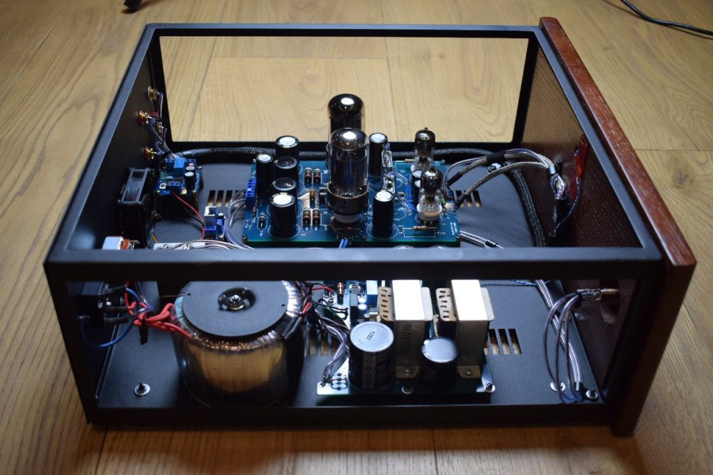

The proposed scheme is a stage with dynamic load without an output transformer and an input voltage amplifier. The output resistance of the amplifier is about 100 ohms.
The lower half of the stage has a fixed bias on the «underground resistor». This solution is taken from the circuitry of the 1920s. Despite the fact that such schemes are considered obsolete and not used today, this type of bias provides excellent sound quality.
The rectifier section uses old Philips diodes. The current consumption is too great for tube rectifiers.
The tracks on the bottom of the PCB are coated with gold and a special varnish.
American vintage solder Kester is used .

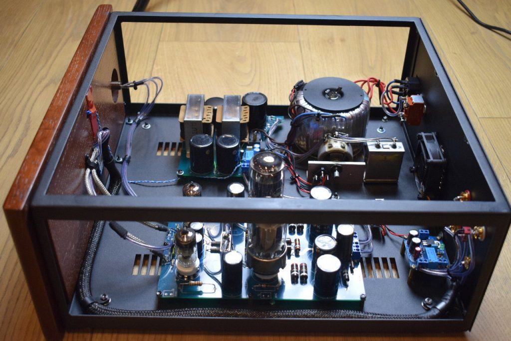

Input tube is EC86 / 6С3П USSR / 6С4П USSR
This tube has several advantages — high gain, low noise level, high resolution, ability to work at a low anode voltage.
There is a second version of the amplifier, with auto-transformer at the output. This version allows connecting headphones with an impedance of 32 ohms and below.
The plate load of the first stage are Audio Note tantalum non-magnetic resistors. Black Gate capacitors are in cathode circuit.
The choice of other parts is subordinate to the main task — musicality combined with high resolution.

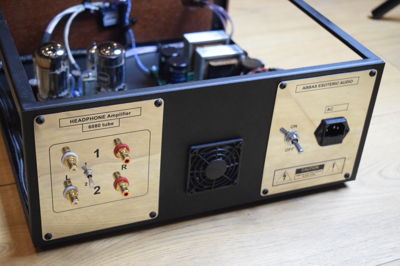

Technical data:
Range: 5Hz…300kHz at -3dB.
Maximum output voltage : 15V RMS at a 600-ohm load.
With the load reduced to 50 ohms, the output voltage decreases to 7V RMS.
Two swithced inputs
10kohm or 50 kohm input impedance ( preorder)
Gain= 35db at 600 ohm load
The amplifier weighs 12kg.
Dimensions 400/400/170 mm.
